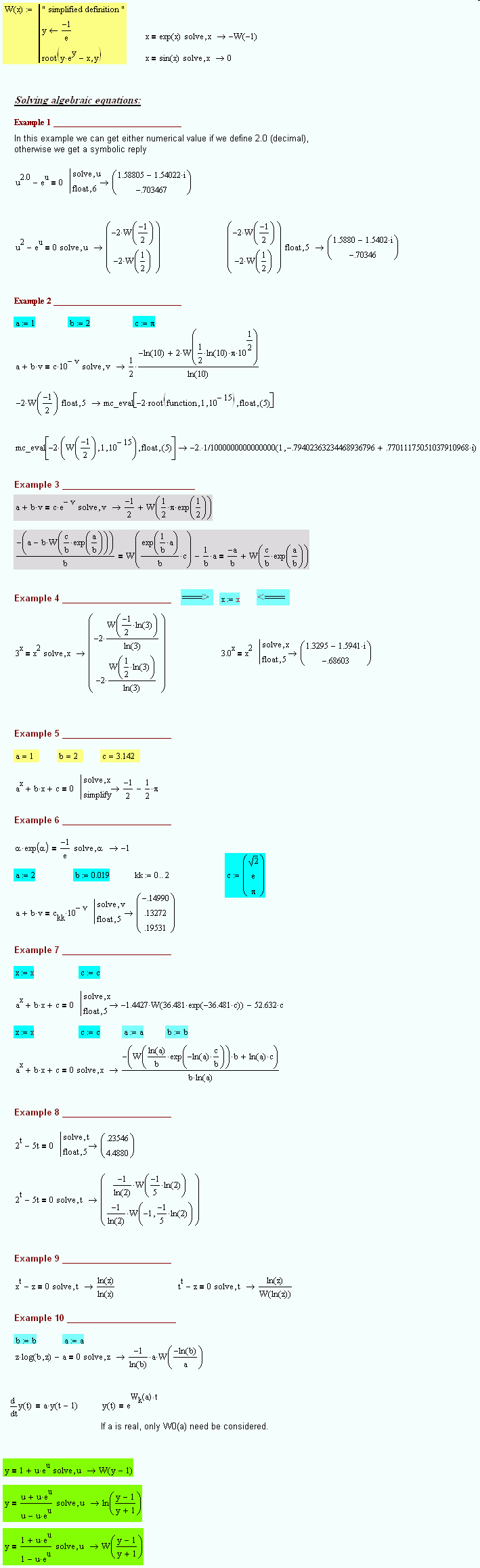

"Transcendental functions", i.e: algebraic equation are generally solved in closed form via special functions. Here solving with Lambert (W). 15 examples attached + an example of symbolic indexer.
