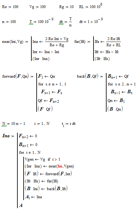

The paper ‘Modelling the transient emission from a twin-conductor cable’ describes a test where a step pulse is applied to one end of an open-circuit cable. -  http://ietdl.org/t/ZKt6U
The waveform of the differential-mode current delivered to the line was recorded. This was different from the waveform of a lossless line, since there were radiation losses. A circuit model was created to simulate the hardware-under-review and was subjected to transient analysis. Adjusting component values of the model enabled close correlation to be achieved between test results and model simulation. The process of creating the model provides an improved understanding of the mechanisms involved.
The ‘References’ section of the paper includes a link to the Mathcad worksheet which performs the calculations.

I wonder what side-effect your first sheet (Fig2) runs on. I get this (in Mathcad 11):
The variable 'Ini' is undefined.
However, with this change it runs:

With Mathcad15, there was no need for me to pre-define the variable Ini. So I didn’t.

Not sure what sort of comments you are after, but I've looked at figure 2 in a somewhat different way.  The attached worksheet shows all the currents rather than just Ina.
(I used M15, which doesn't give the problem in the original figure 2 worksheet that Luc experienced, as it assigns initial values of zero by default)

It is possible to carry out bench tests on prototype equipment using a signal generator and oscilloscope to measure the susceptibility and emission characteristics of the equipment; then to create a circuit model to replicate that behaviour. The model can subsequently be used to predict the results of formal EMC Tests. Mathcad software is uniquely capable of carrying out all the calculations and presenting the results in a form suitable for peer review. One example is provided. The technique is capable of analysing any form of EMI coupling.
