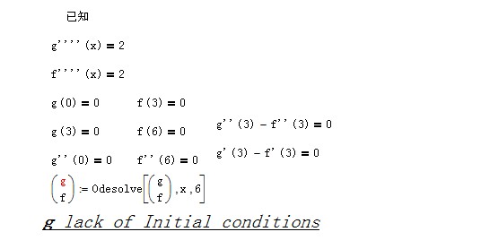

Trouble in solving ordinary differential equation,why lack of Initial conditions? THANK YOU VERY MUCH!
  • April 17, 2013
  • 3 replies
  • 1608 views
This is an ordinary differential equation,why "g" lack of Initial conditions?
Who can help me solve this problem ? Thank you very much!

April 17, 2013
Odesolve doesn't like initial conditions specified in the form g''(3)-f''(3)=0. However, since it is clear your functions must be 4th order polynomials you can solve for them as in the attached.
Alan
April 17, 2013
Here is a slightly neater way of generating f(x) and g(x).
Alan
