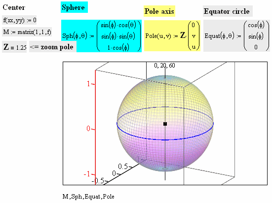

I have 3 surface plots and one vector that I would like to plot in the same coordinate system.
The situation is the following (axis scales are predefined and fixed):
1) Each plot by itself works fine
2) If I plot one surface plot and the vector the vector is reduced to a dot
3) If I plot a second surface plot to an existing one mathcad does the "divide by zero"-error.
Any help or work around appreciated! (I run Mathcad 14 on 64-bit Windows 7)

If the vector is so short, then scale or otherwise mesh the surface plot on the same scale as the vector.
jmG
August 4, 2010
The principle of scaling a vector [pole] and the surface plot.
No matter the type of surfaces and vector, just plot what
you have, if plottable ... You may have to do some re-work.
jmG

Sorry for the inconveniences - new file attached with all the single plots i want to make at the bottom
Scaling solved the Vector problem (might still be incorrect in the attached file but I solved it now)
However, two surface plots in one graph is still a problem.
Maybe the error is the following: when trying to plot in a defualt coordinate system Mathcad always does the divie by zero error which is correct regarding the functions i attempt to plot. I then have to adapt the quickplot data to make it work. But when adding a second surface plot to an existing one it wont let me access the quickplot data anymore for that plot but automatically does the divide by zero error. I can still access quickplot data for plot one.
Thanks for your time!
