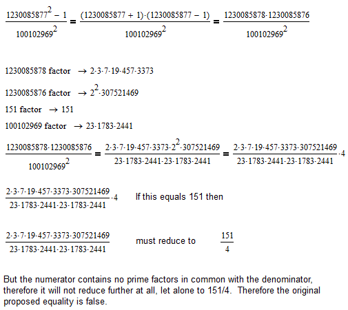

Best answer by IRstuff
The answer is FALSE. Even Mathcad 11's symbolic processor shows: False.gif The same result comes from Mathcad 14's symbolic processor, which is from a different source, i.e., MuPad vs. Maple.
So, Mathcad's numeric processor, which is limited in its numerical precision winds up truncating the answer. The symbolic processor's floating point answer is
which, with careful digit counting shows that the numeric processor of almost any calculator and any normal spreadsheet program will truncate the answer to 151, but it's not. You may wish to find some aribtrary precision calculators, some of which can be downloaded from the web, to verify the results. Prime factorization in Mathcad shows the ratio to be composed of products of different primes.

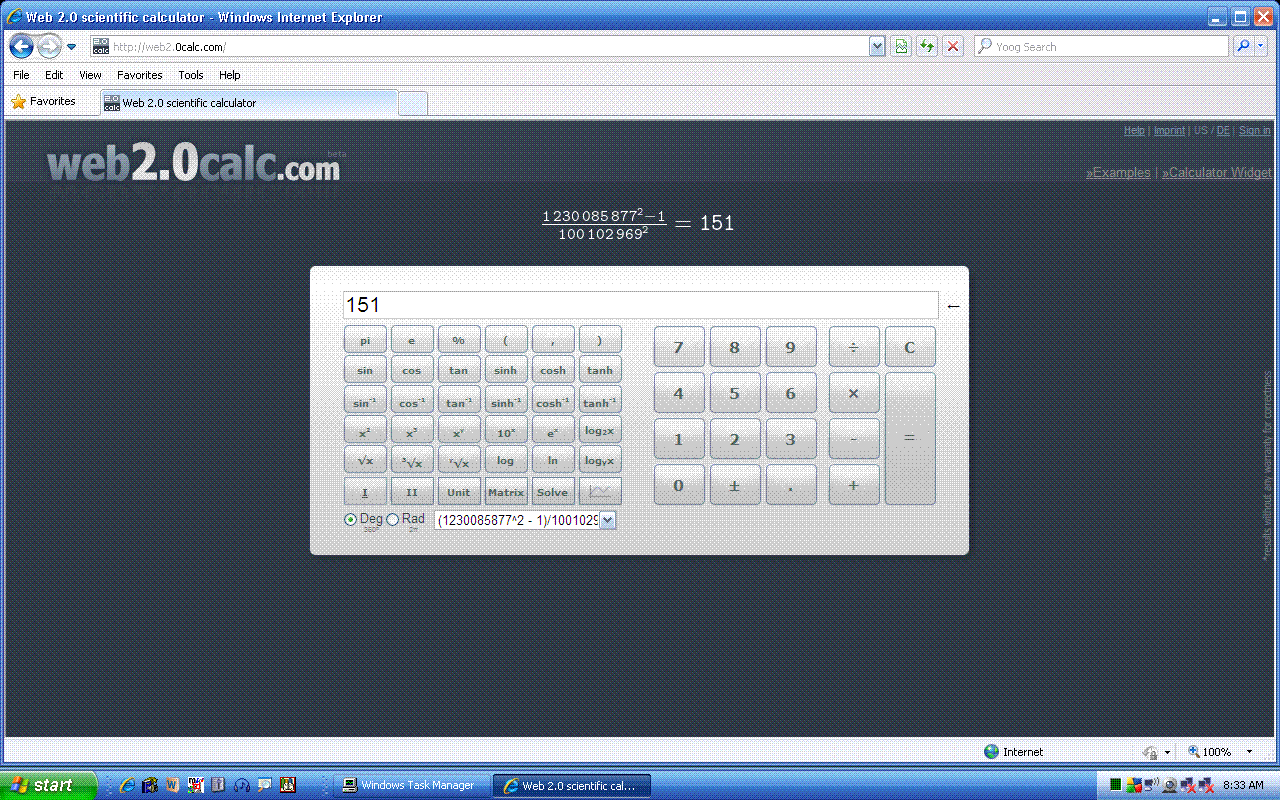

Mathcad says it's true.
August 29, 2010

Alan Stevens wrote:
Mathcad also says:
No, Mathcad says:
MuPAD kernel (in Mathcad) says

Excel also says it's true.
151.00000
Mike

The question that needs to be asked is what definition of equality is required.
strict mathematical: exactly equal - answer is unproven but probably not (see Alan's post)
Finding a calculator that has higher resolution / precision may give more trailing zeroes but the reality is that at some point there must(?) be some inequality.
scientific:e.g better than1 part in 10^12 - yes, its good enough.
engineering: +/- 1% (usual tolerances that can be expected ...)
Andy
