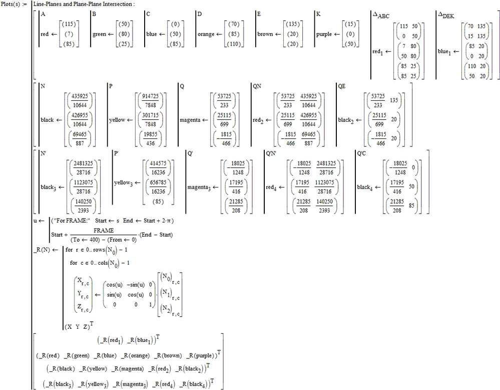

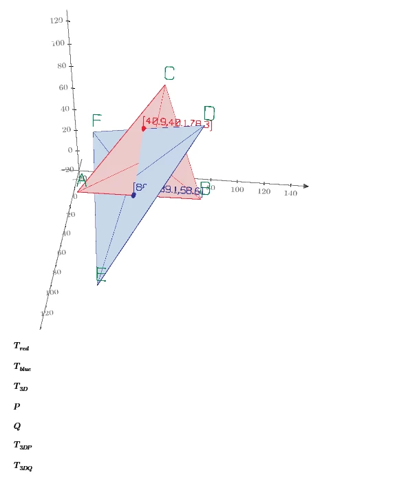

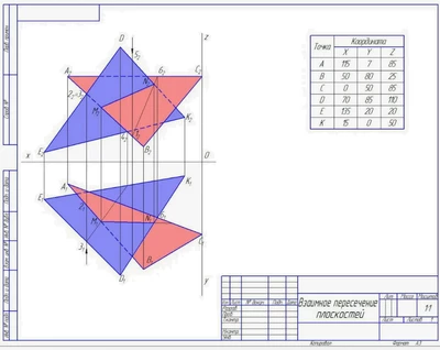

When I was a student, we solved the following problem in a class on descriptive geometry (now it’s engineering graphics). There are two triangles in three-dimensional space. Triangles intersect. You need to draw triangles in stereometry and in three projections. The triangles are colored - one red and the other blue. It is also necessary to draw a segment of their intersection.
Can this be done in Mathcad? Better than 15th.

I use ABC and DEF for names of the points.  I also studied this 50 years ago.

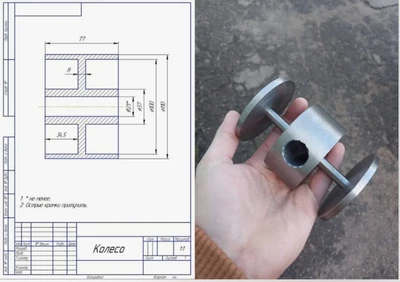

But where is the Mathcad-file?
Yes, if you can't read blueprints, then...
Feb 23, 2024 4:01 PM UTC
That's really funny, I like it! Even though its completely off topic concerning your initial question.

Adding the points and line of intersection should not be that big a problem for any of us.
20-Turquoise
Feb 26, 2024 6:05 PM UTC
Hi, Valery. :
00. Line-Plane and Plane-Plane Intersection 1.png00. Line-Plane and Plane-Plane Intersection 2.png
(view in My Videos)
   Regards.
