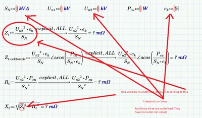

I've been caught on this one before.  First on the Calculation Tab under Calculation Options, activate "Units/Constants in Symbolics".  Then in the same tab, hit Calculate.
I have made that change to your document and entered some dummy values.  It works now.

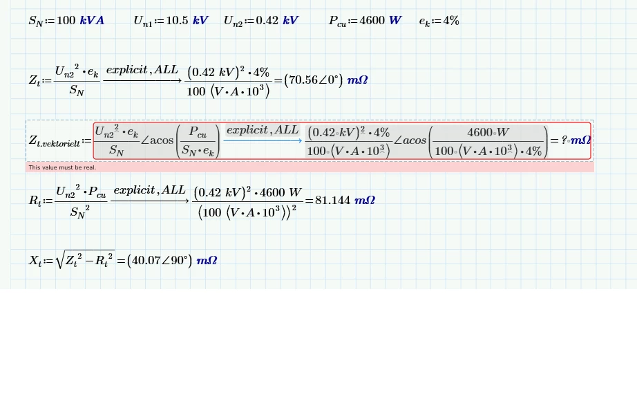

Wow, thanks for a quick answer. It did solve SOME problem. But now a new one occurs.. "This value must be real"
Thats what it ways when I input data to the variables.
Please see the attached screenshot, its from page 2/7 in the worksheet.
I hope you can figure it out, i believe in you!
/Frederik
Mar 16, 2023 8:28 PM UTC
The problem is the acos() expression you use. With the values provided, the argument is greater than 1 (1.15) and so the angle is non-real. You have to provide a real angel, hence the error.

Hi Luc. I know how to input data to my variables, however this is not my problem. When I fill in data, it still gives me an error.
