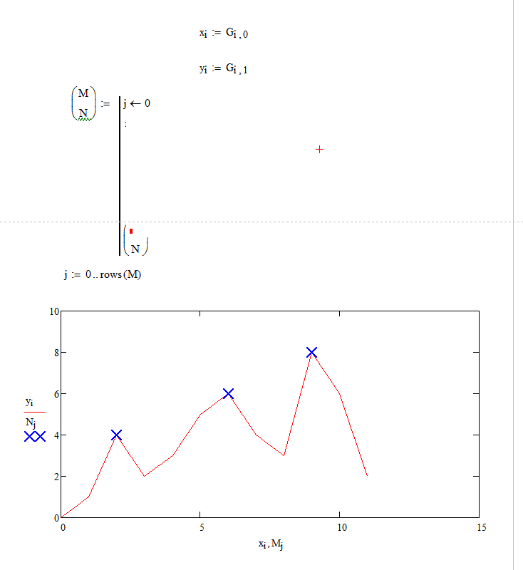

Right I have made some progress but I have ran into a problem, I do not know how to find the local maxima of the graph! I can see it of course, have I just to trace the point and state it or is there a method of finding it?

ok here is what I have, the lecturer assures me this is the way I have to do it!
amcmillan1-VisitorAuthor
December 4, 2013
So its not what is in the mathcad help it is completely different! all I have to do is define this program and I can find the maxima but I dont know how as we have not been taugh how
December 4, 2013
Looks like you are nearly there.
Have a look at the programming toolbar at the top.
It will give you access to all the functions that you need.
There are many ways to achieve what you want but I guess the object of the excercise is to allow you to explore the options.

December 4, 2013
Obviously not.
Alison is argumenting that she never was tought anything about loops, conditions and how to program at all and so it seems to me she thinks she is supposed to solve the assessment without programming at all.
I also guess like you that she is supposed to explore programming on her own and experiment with the possibilities to finally come up with something like the attached (vital part is locked for the same reason you didn't disclose your procedure). I thought that Mathcads built-in help would be a good starting point but it seems it wasn't. Unfortunately I am not aware of a suitable basic tutorial on programming in English to help out.
December 5, 2013
Ok I figured it out! How to get the maxima!
I used a for-loop function but I had to fiddle about with it for a good while!
December 5, 2013
Thats is, yes!! And I guess you were supposed to fiddle around for a while.
In case you wonder why the routine in the help is much longer - this is because the first and the last data point is also considered. In your routine the two end points never will end up as relative maximum. It may be a matter of definition, but if the first point has a larger y-value than the second, it can be considered a local max as ther is no data in the surrounding which is higher. This would be the case in your sample data if the firest y-value would be changed to 2.
My approach is a bit more tricky (the password for the protected regions is "euler" without the quotes) as I used two auxiliary routines left() and right(). left() will go to the left of the current data and will stop if it arrives either at a data point with a differént y-value than the current or at the end at index 0 and returns that value which is then compared the similar way as you did with X[j-1,1. That way I can run through the data including the endpoints from 0 to rows()-1 and because I used <= instead of just < the routine acounts automatically for the endpoints and for consecutive data of equal values. But it may be a bit to tricky for this assignment.
