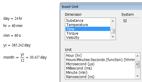

You can use an user defined unit of time:

I've discovered the units and such. But I was trying to find a way to specify something other then just days and years.
Lets see if this works. I also think I found a workaround. But it is example 8.11 and the worksheet is a slight mess as I havent taken the time to clean it up completely. But Under solution I would like to find a way to make it display 32.877 mi/day 4.932 x 10^9 mi/day 7.397 x 10^9 gal/month etc. . .
