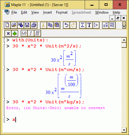

Mathcad 11 gives the correct answer
June 28, 2016
Sorry, it is not correct answer!
Maple gives the correct answer:
June 28, 2016
Just for meters, and probably for others. What do you have in mind with that, Valery? Which physical significance is, as LucMeekes ask?

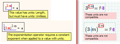

Exponents have to be unitless, like the argument of a logarithm function, e.g.
So Mathcad 11 and also Mathcad 15 and even Prime are right. Primes error message is less meaningful, though.

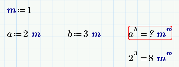

If you chase down thru and find Val's sheet, there's a cute little expression near the top
m := 1
He's not raising units to units, he's raising 1 to the first power.
m := 1
Yes, I noticed that. But he seems to insist that unit^unit should make sense in a math or physical way.
