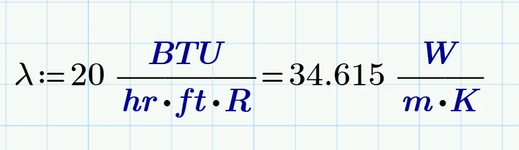

January 10, 2018
Better use here R and K not F and C
January 10, 2018
Δ°F = R   and   Δ°C = K
The difference is merely display.
January 10, 2018
I asked my colleague from NIST why you have R in the unit of entropy, and in thermal conduction unit F. He answered that it is easier to change the US Constitution than to teach American engineers to use R in the thermal conductivity unit, rather than F.
