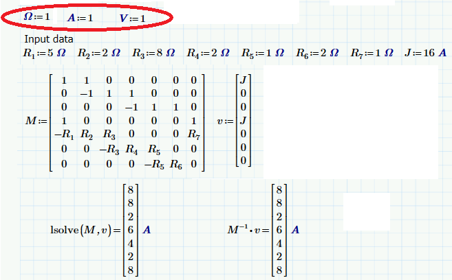

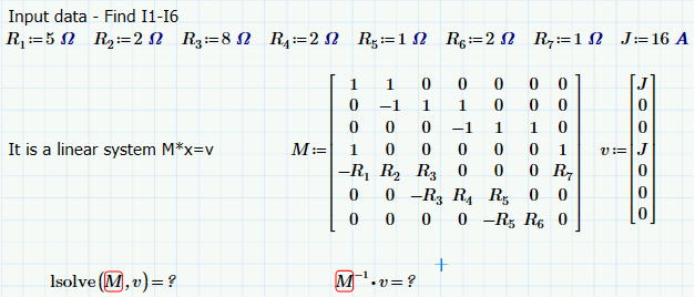

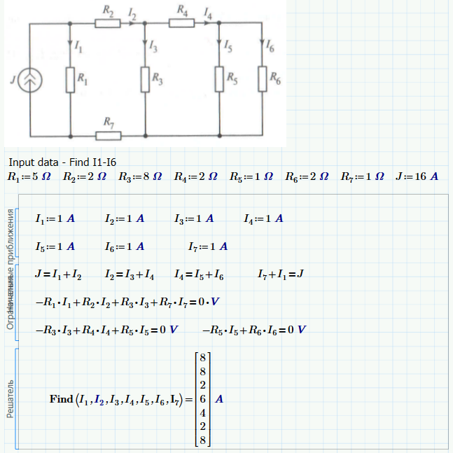

One task (see pictures and load files Mathcad Prime 2.0):
All is OK!
But it is a linear system and it is better use the lsolve function:
Mathcad Prime can not works here with units and I must do so:
It it a bug in new possibility of Mathcad Prime (different dimensions in array) or I do something wrong? Thanks!

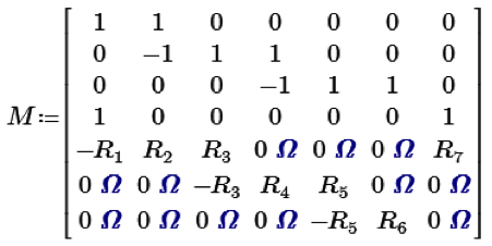

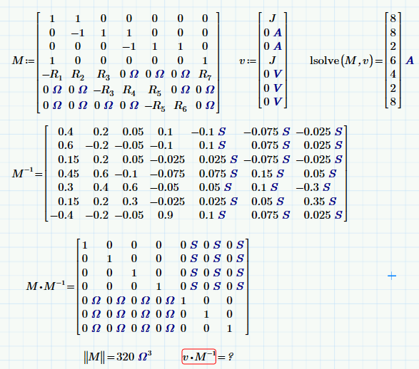

In a mixed unit matrix, you need to assign the units to 0's explicitly.
Define:
--Jakov
September 11, 2013
Thanks, Jakov!
But in the Solve block 0 and 0*Unit is equal - it was my...
Better use not V, ohm and A but mV, mohm and mA

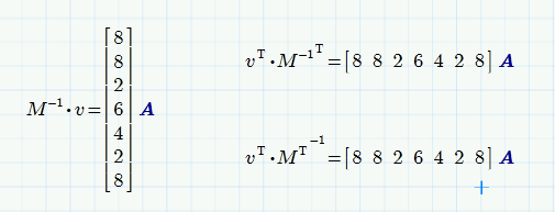

And second:
September 11, 2013
Not sure what the problem should be? v*M^(-1) can't work - using units or not.
