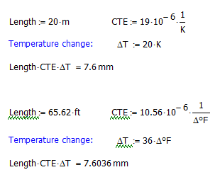

I am new to MC 3.1 and struggling with units.  For instance, how do you input the units for the coefficient of thermal expansion - 1/F or 1/K?
10 replies
June 16, 2016
Just enter the unit (K or F) then raise it to power -1, by typing
^-1
to get:
Or
After the numeric value type
*1/
then add the unit, to get:

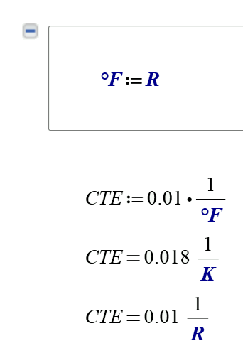

IMO, overwriting the built in units so that °F is wrong is not a good solution, and may lead to serious errors elsewhere in the worksheet.
June 16, 2016
Temperature units are confusing, because you cannot simply convert one to another using a scaling factor. When using units other then Kelvin or Rankine you must distinguish between a temperature, and a change in temperature. For example:
T=300°C
ΔT=20°C
The obvious conclusion is that the new temperature is 320°C. But suppose I convert to Kelvin, and then add:
T=573.15K
ΔT=293.15K
So the new temperature is 866.3K=593.15°C. This answer is wrong because the change in temperature was treated as a temperature relative to absolute zero, and not a change in temperature. This is why Mathcad provides the units °C, Δ°C, °F, and Δ°F.
With that in mind,
