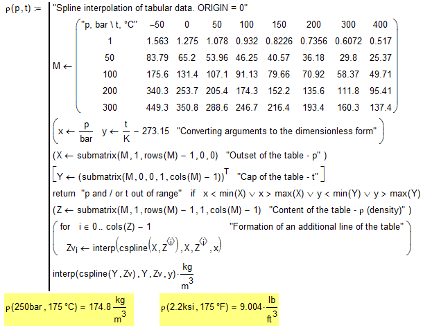

Is there a way to assign units to values in tables?
eg: i would like to use a table for density of air at various pressures and temperatures
t [O C]-50050100150200300400
ρ [kg/m3]
1 bar1.5631.2751.0780.9320.82260.73560.60720.517
5083.7965.253.9646.2540.5736.1829.825.37
100 bar175.6131.4107.191.1379.6670.9258.3749.71
200 bar340.3253.7205.4174.3152.2135.6111.895.41
300 bar449.3350.8288.6246.7216.4193.4160.3137.4
Is there a way i could create such a table with respective units for each of the values so that if I use a lookup function to find
hlookup(300K,table, 150bar)=, mathcad interpolates b/w nearest values in the table and gives me an answer
similarly, is there a function for interpolation and extrapolation from table values such that if i try to look up ρ at 50O C & 10MPa) it should automatically interpolate b/w the nearest actual points present in the table and provide a value.

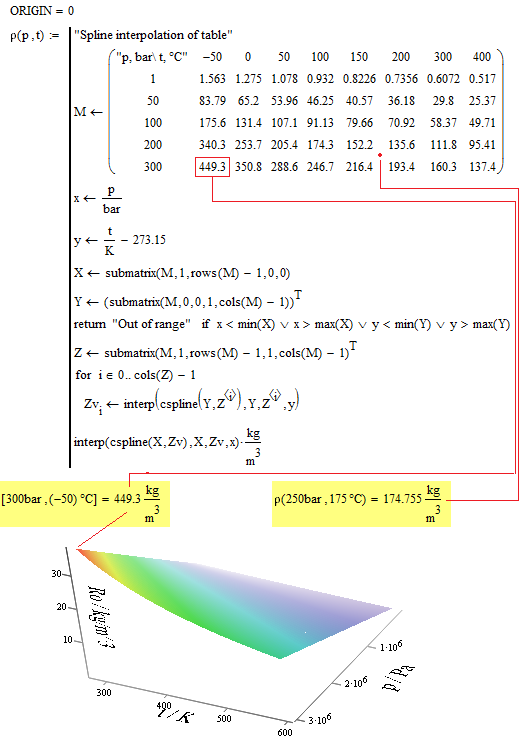

In Mathcad Prime - no problem to have a matrix with different dimension (see too my wish - http://communities.ptc.com/docs/DOC-2151).
In Mathcad 15 no problem to solve your task - attach please your tabel as Mathcad matrix or as Excel sheet and I will do it. Now see please a solution one same task -
http://twt.mpei.ac.ru/ochkov/Mathcad_12/4_03_3D_Spline.png

Solution in attach.
See the pictute too:
February 2, 2013
More compact program with remarks:
February 4, 2013
Thanks Valery. It's a really neat piece of code.
