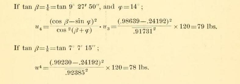

From the first volumes of the Transactions of the American Society of Civil Engineers (just an example), units have been printed in roman. The following excerpt is taken from Volume 2, published in 1874:
You will notice that:
  • pound units (lbs) are typed in roman. (Units are in roman throughout the Transactions)
At the same time, notice that:
  • intermediate numerical values are shown;
  • variables are not unnecessarily repeated in the second equation; (u⁴ is a typo, it should read u₄)
  • the symbol for multiplication is ・ when used with variables and ✕ when used with numbers.

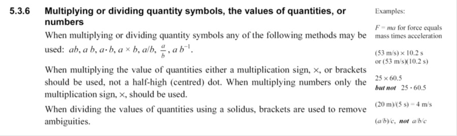

The last point is mentioned, 142 years later, in the current International System of Units:

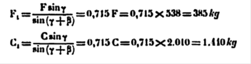

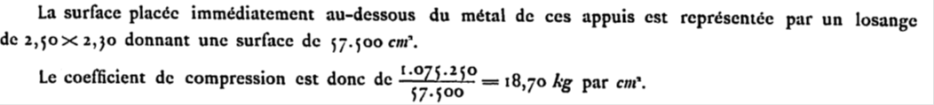

In the year 1900, Gustave Eiffel published a voluminous book describing the main structural and mechanical aspects of design, construction and operation of the Eiffel Tower. Here is where it gets crazy. Units are printed in italics both in the text and in calculations!
Wow! At least, I won my own challenge and please don’t tell me that Eiffel did not know what is was doing.
But today units must be printed in roman. It all about standards and legislation. At first, governments are expecting that the changeover to SI will be done on a voluntary basis. Eventually though, companies that do not abide by the law may be subject to fines. Boards of Professional Engineers may not appreciate the fact that engineers do not document their work in the most appropriate way. The ISO certification of some engineering firms could be jeopardized. Who knows, but then you will be arguing with these people, not with me.

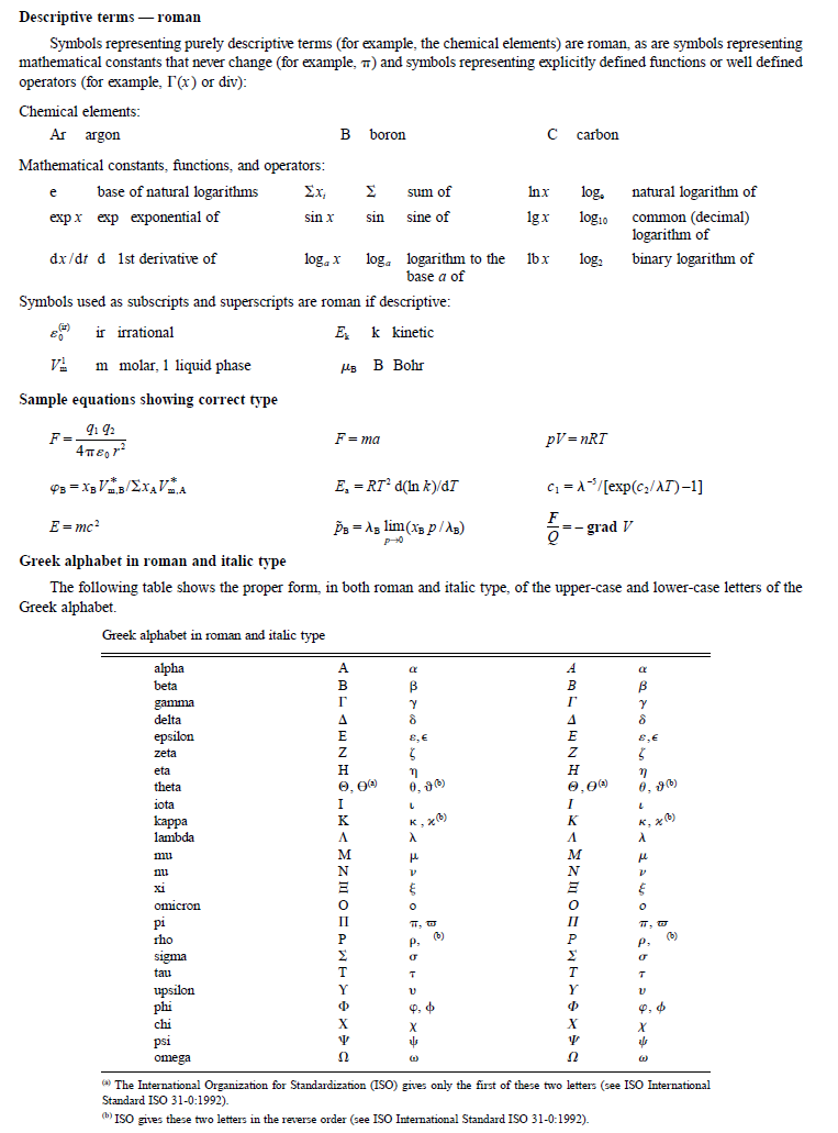

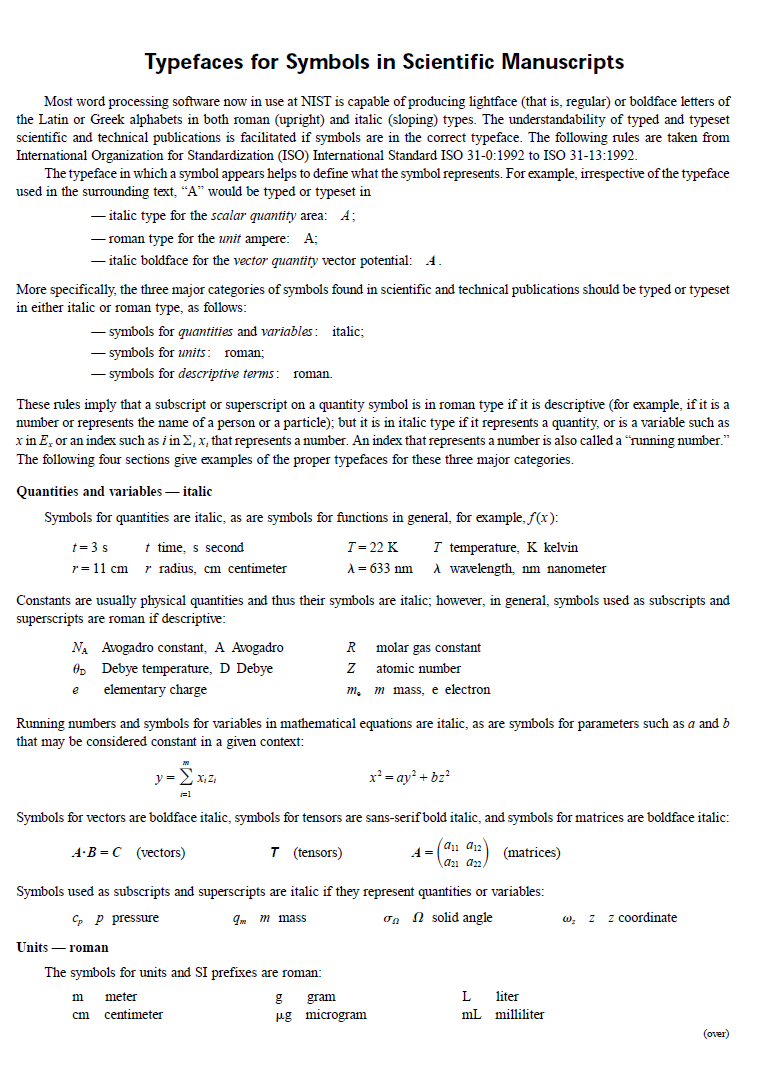

Here's another item from NIST:
Typefaces for Symbols in Scientific Manuscripts
