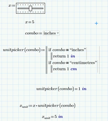

You can't directly put units on any advanced control...
...But what you will see on PTC's own worksheets would be something like
x: [slider] and then x2 or xunits: x*cm.
And then you use xunits for any further calculation or input.
Edit: If the unit varies but you want to use the same slider every time, then... you can be a little more creative. I came up with something like this...

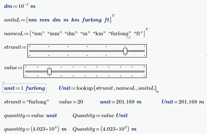

Not that I wish to be contrary, but after pondering this matter for a few milliseconds (or thereabouts) 🤔. an obvious (for values of "obvious") solution occurs to me ... 😈

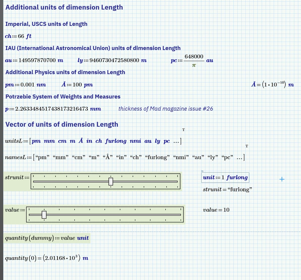

I'm not a huge user of units, but this was a requirement that I've had on occasion.  Before Mathcad Prime 10, I went with a traditional lookup approach (see postscript).  Now that Mathcad Prime 10 is here, I slotted in an advanced control to choose the unit (as did you) before passing it to the lookup function.  However, a few minutes ago I spotted something in the advanced control Help that gave me an idea.  And voilà (or whatever French for "look there" is).
The clue is there in the image ...

Nov 15, 2024 1:39 AM UTC
So you were kind enough to have the button "Show in Worksheet" pressed 😉
Clever idea and sure looks better than using 'lookup'. After all the vector unitsL isn't needed in your approach anyway.
I would rather use a listbox to choose the unit instead of using a slider (even if it would take up more vertical space or requires scrolling), but that may be just a matter of personal preference.
If the number of units to choose from is not too large, radio buttons may be an option as well. Unfortunately they can only be arranged in a column or in a row but not in matrix formation.
It may also be an option to define the value in front of the unit selector and use it as its second input
