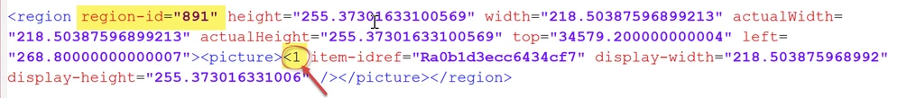

I mistakenly attached a photo with a wrong extension to my MathCAD file.
Now, it's not opening
The version is Prime 7.0.0.0
I will appreciate a lot if you could help me recover the file even if it will be just the texts and equations!

EDIT: In case somebody is interested. To fix the worksheet only one small modification is necessary. Because we see in the "media" directory that the file "Image891.1" has a wrong extension "1", we have to look for "region-id="891" in the file "worksheet.xml" and there we have to replace the wrong file type "1" (see picture) by "png" .
Thats all thats needed. At the end all seems to be that easy 🙂
It would not have been necessary, but I additionally changed the extension of the file "Image891" in the "media" subdir to "png" and also edited the file "worksheet.xml.rels" to reflect that change in file name.

The file with the wrong extension was "Image891.1" and it should have been "Image891.png".
Unfortunately I was not able to bring the sheet to live.
An mcdx file actually is just a renamed zip file. So if you rename it to *.zip you can unzip it and inspect its contents.
That way it was easy to extract the pictures. I attach them here in a zipped archive, the wrong extension is already fixed.
