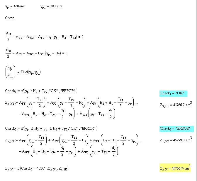

I have a simple solver in the format
y:=guess Given
formula1=0
y:Find(y)
However the formula is dependent upon a boolean criteria so I want this format:
y:=guess Given
if criteria 1
Formula1=0
else
Formula2=0
y:Find(y)
I can solve the two formulas then check the criteria then select the correct solution but this seems longwinded or unelegant, see attached!
How can I do this in a compact way?
Best answer by wayne
See attached, in green, for a different way
(put the two criteria in an if statement = 0)
Wayne
July 18, 2011
My solution (in Mathcad 15):
wayne12-AmethystAnswer
July 18, 2011
Wayne
