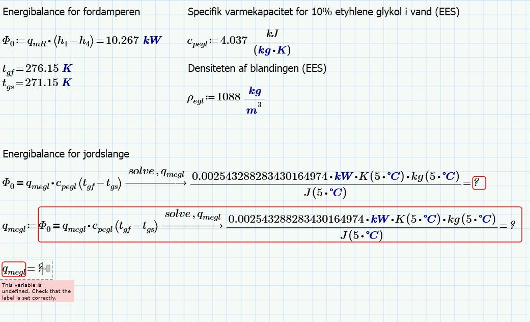

I just downloaded Prime to try it out, and i like the layout and general feel a lot better than MathCad15, but I've run into a huge problem.
I used the symbolic solve in 15 a lot, solving for a missing variable in an equation, where all others were defined with units and then using the normal '=' in the evaluation tab. Then 15 would combine the units and spit out a useable result, where I could change the units by writing the desired unit on the end. The picture below shows what i mean:
Now trying to do the exact same thing in Prime 3.0 gives me the following
Any help would be appriciated!

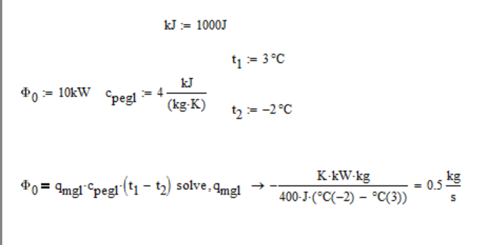

Actually, your problem is that Prime doesn't recognize kJ as a unit. Define that and . . .
23-Emerald I
Dec 15, 2014 4:35 PM UTC
You're trying for a symbolic solve; but the symbolic processor doesn't recognise units. Try a numeric solve block.
