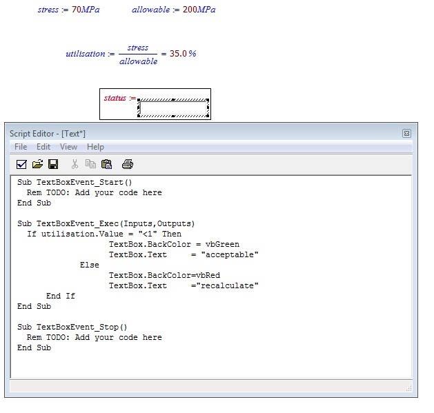

I'm a newbie here so please bear with me as I'm sure someone has already covered this topic but I can't find a thread anywhere.
In a nutshell, I want to get make a textbox to change colour dependent on what answer displayed in the box.
I've just completed the MathCAD 15 course and the instructor showed an example of this working, so I asked him how to do it. He told me it was al to do with the VB script running behind the text box and sent me the script.
When I tried to insert this into my own text box script it wouldn't work.

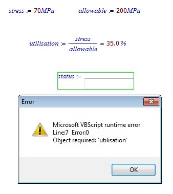

Adding it is not a problem (copy and paste) but the problem I’m having is trying to get the script to refer to the output of a previous calculation. I don’t quite understand how VB scripts work so I’m a bit lost as to where to add my references.
This is what I’ve tried so far….
…but when I come out of the script, I get this message…
…I’m at a bit of a loss.
Can anyone suggest anything? Or is there any possibility that someone could show a simple example of how to write this script properly please?

Hello Hong Thoi,
within the VB Script Editor remove the quotation marks so that it reads
If utilisation.Value < 1 Then
instead of
If utilisation.Value "<1" Then
You've compared string with integer and VB doesn't like that.
Raiko

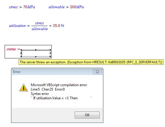

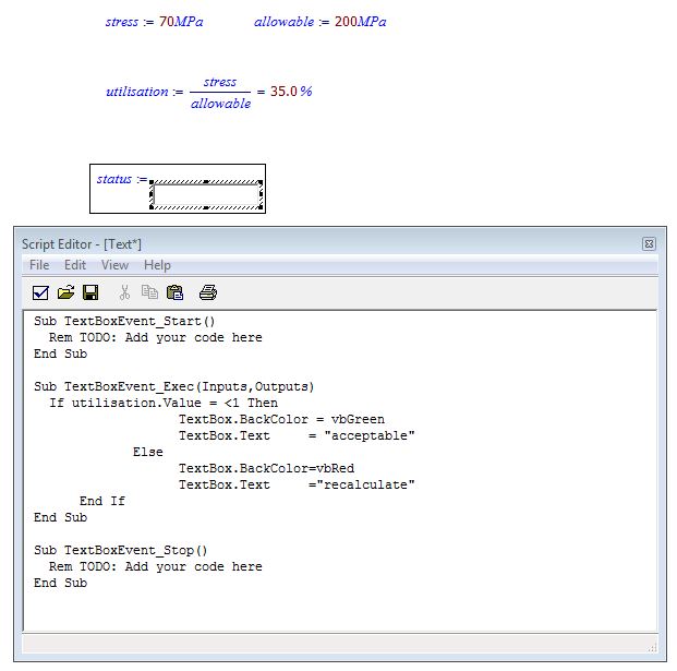

Hi Reiko,
Thanks for your reply.
I tried removing the quotation marks as you suggested like this...
... but got a different error message instead...
any ideas? (sorry about my lack of VB knowledge, I thought this would be quite a simply script for me to start on...)
March 4, 2014
Try removing the = sign (the one after utilisation.Value) Or change it to <= rather than =<.
