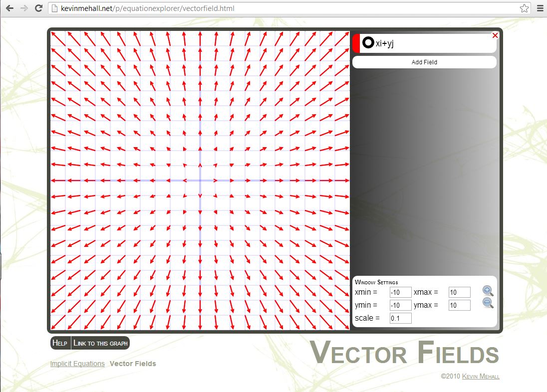

I'm having trouble finding a way to create vector field graphs in Mathcad Prime 2.0. For example:
Is it possible to create such graphs in Mathcad Prime 2.0?

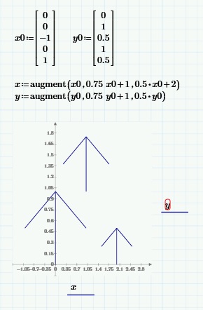

It might be possible.
The image below shows x & y basis for drawing an arrow. Augmenting scaled versions of these gives a matrix that can then be plotted using a waterfall plot.
I've only got Prime Express, so can't program a function to handle the translation, rotation and scaling, plus I'm too idle to add rotation in for a demo.
