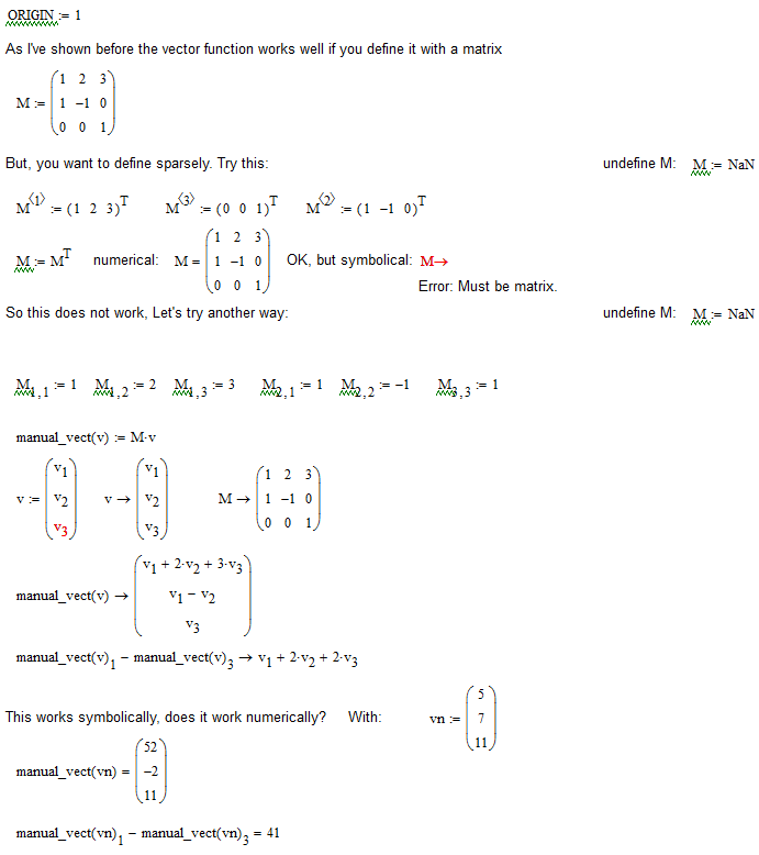

Like this?
23-Emerald V
Like this?
Succes!
23-Emerald I
What am I missing?  See attached.

LucMeekes23-Emerald VAnswer
23-Emerald V
Does this help?
Does this do what you want?
If I understood the thread correctly so far, your problem/question (or at least one of them) is, that you don't want to add the necessary zeros manually.
Maybe a programmed approach like the following could help:
Regards
Werner
Here is a better variant as the function vector is called just once in this version:
