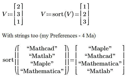

Feb 12, 2015 5:47 AM UTC
(My answer as long as everyone in Europe and America are sleeping)

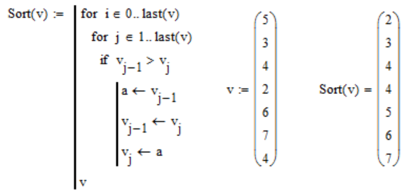

One KISS-program
PS
We need swap(a, b) function (a procedure) in Mathcad!?
