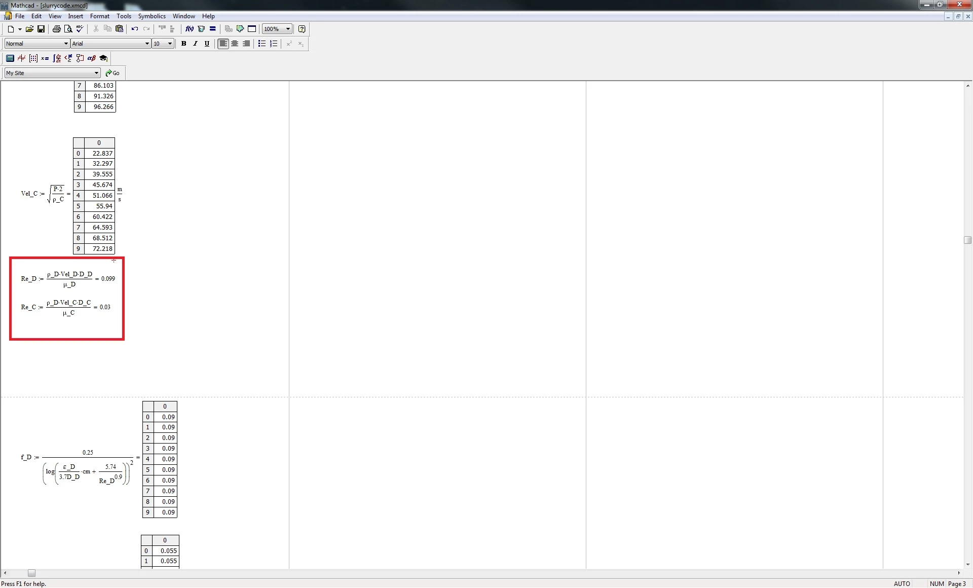

Hello Mike,

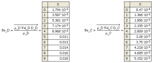

I have attached a picture of the code. And I lied. I'm trying to multiply to vectors together; Vel_D and D_D.

Looking at the image it seems that the vectorize operator will work.

Defining vector multiplication (or division) using the standard multiplication sign has always been assumed to be the vector dot product, which results in a scaler answer. (The cross-product is available for three-element vectors.) To multiply element-by-element requires that the product be "vectorized," as you have already found out. It can also be done by indices, but the process is much slower.
