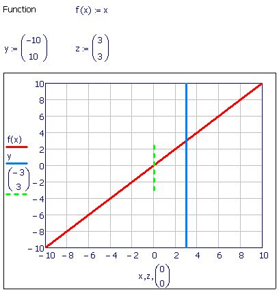

Good day everyone,
If I plot a very simple funktion, like f(x)=x, and I want to display vertikal lines in the plot, for example at X=4, how is it done? Horizontal lines are no problem using f(x)=4 🙂

There's more than one way, but this approach is the most versatile.
February 16, 2011
Have a look below. There is another method using a pre-defined function - Lines which has been passed in the forum before. But if you only want a few lines this might be a simple solution.
Mike

February 17, 2011
Simon,
Just as a hoirzontal line is y(x)=3, a vertical line is x(y)=3; the dependent and indepentent axis can be interchanged, Mathcad don't care.

February 22, 2011
Simon,
Sorry, I did not realized you were working with the US budget deficite. Try using units of 1one trillion dollars.
