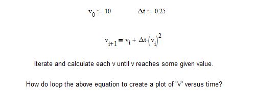

I am still learning programming for mathcad. I have attached my workbook. Here is an image of what I have and what I need:

Which time would you like to plot v over? i, or is t[i:=i*Delta_t?
If v should denote velocity and Delta_t a time difference, it seems there is something wrong with your iteration formula. You would try add length per time and length^2 per time!.
September 30, 2013
I think instead of time, I want to just graph each value of v. so v0,v1,v2,v3,v4 etc. not explicitly time.

Find attached a few possibilities to achieve what you are after.
Plots are over time, change t to i if not wanted.
