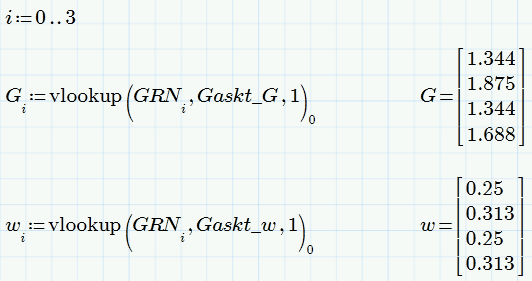

Hi Mathcad Users,
I am using PTC Mathcad Express Prime 3.0 for the first time.
In the attached file, I have G & w being pulled correctly using the vlookup function, but I would like the results in full Matrix format that I could then use for further work - Basically, I want my G & w matrices to look like G_desired & w_desired.
Any practical tips on how to accomplish this would be appreciated.
Joseph Thodiyil
Best answer by Werner_E
Maybe that way
BTW, in accessing the elements of a vector (= n x 1 matrix) you do not need to specify the second index (,0).
The [0 at the end of the lookup call return the first element of the vector which is returned by lookup. lookup has to return a vector as it may be that it finds more than one occurence of the given parameter.
Werner_E25-Diamond IAnswer
November 22, 2013
Maybe that way
