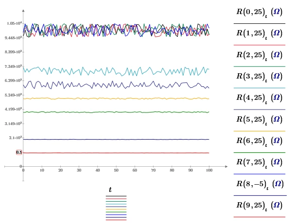

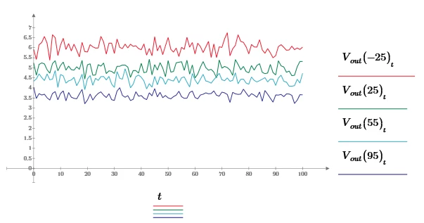

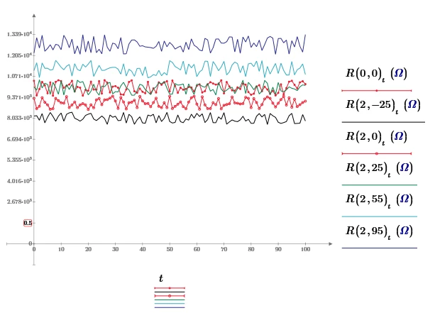

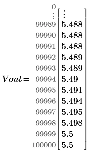

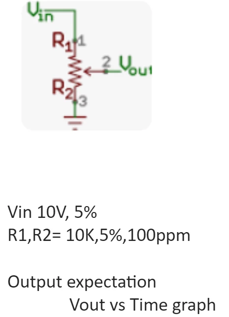

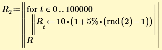

I need to do Monte carlo Analysis of mentioned circuit...I have to generate a matrix with that I have to plot a graph. Vout vs time

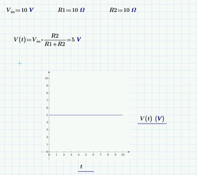

18-Opal
Mar 22, 2024 4:36 AM UTC
Like this?

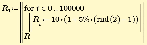

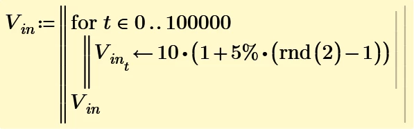

Mar 22, 2024 11:19 AM UTC
Assume uniform distribution. Not use 100ppm for R1 and R2.
t.t.
Mar 22, 2024 1:05 PM UTC
As I see it, the values of R1 and R2 may be chosen within the tolerance of 5% (maybe normal distributed?) but once chosen, it won't change over time.
The only change over time may occur because of the temperature coefficient of +- 100 ppm/Kelvin.
Its unclear if the input voltage would be allowed to change within its tolerance of 5% over time - guess yes.
Its not clear to me what kind of Montecarlo analysis is asked for and what plot of Vout over time? In my understanding, a plot over time would not use the 5% tolerance of the resistors.
