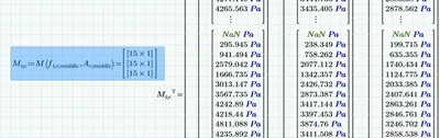

I have a question >> What it is the difference when mathcad write the unit of a resulte inside the brackets [result*Unit] and outside [result]* unit?
is there any difference ? and how to make all units showed the same way?

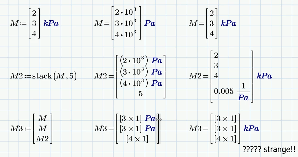

If all elements of a vector/matrix are of the same dimension, then Prime uses to place the unit (for all elements) after the matrix and you are also allowed to change this unit to something you like more.
If the matrix contains quantities of different dimensions, Prime places the units right to the values inside the matrix and unfortunately does not allow to change this unit directly. You can write a different unit after the matrix and Prime will change the units inside the matrix accordingly - sometimes with unexpected effects.
In case of nested matrices Prime seems to show units only if all the dimensions in a 'subvector' are the same. Manually editing the unit at the end of the matrix without expanding nested matrices has a strange effect which maybe also could be called a bug...?

Yes, that's why I wrote "without expanding" 😉

You also need to be careful if you have NaNs in your results.   A NaN will attract the units of the first element with units in a matrix.
I noticed it in this thread: https://community.ptc.com/t5/Mathcad/Vectorizing-SIUnitsOf-over-array-containing-NaN/m-p/981787/highlight/true#M214833
There is a bug report in the system that will hopefully deal with this issue in a (not too distant) future version.
I also found that it was commented on in this thread back in January 2023: https://community.ptc.com/t5/Mathcad/Having-fun-with-NaNs-and-mixed-units-in-matrices/m-p/852699/highlight/true#M204913. I was unaware of this thread until I searched for my thread; I also found the '0' problem and that behaviour should also be addressed as part of the same bug report.

Yes my results contain NaN >>> I read the thread , but I don't understand how to solve this bug? should I replace NaN with manual zeros ?

23-Emerald V
Dec 22, 2024 11:47 AM UTC
@YA_10963798 wrote:
@StuartBruff @Werner_E
Hi, Yusra.
In this instance, if you haven't explicitly set the NaNs to have units Pa (or kPa), then the bug works for you if you want consistent units, but it should not be relied upon as a future version of Mathcad may change the behaviour.  It's also good practice to set values to the appropriate units (which I know you know!).
What would you want to happen?
