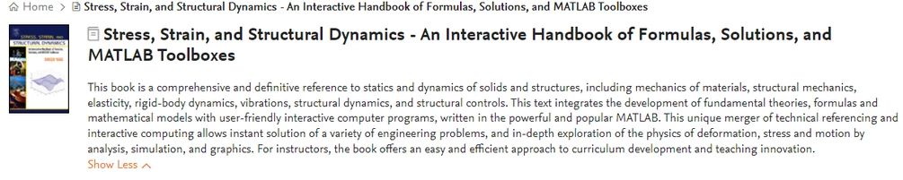

Roark seems not to be available (any more) at Knovel, Peterson a.o. are (not sure if Mathcad/Prime based, though).
https://app.knovel.com/kn/search?include_synonyms=off&page=0&query=Roark
