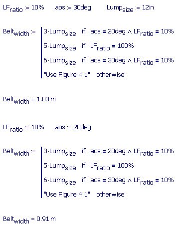

My simple program is not running. Any comments, pl.
Best answer by AndyWesterman
needs 2 minor tweaks,
1. change the final evaluation from symbolic (->) to numeric (=)
2.remove the recursive use of the variable name at the end,
Regards
Andy

Unfortunately my Mathcad Prime is not currently working, but I have reproduced the program in Mathcad. You can try and convert into rime and see if it yields the correct results.
Mike
April 20, 2012
Screen shot attached.
Mike
April 20, 2012
Regards
Andy

April 21, 2012
You solved my problem. Thanks a lot.
RWickrama10-MarbleAuthor
April 21, 2012
Thank you for your reply: your Mathcad R15 file is working exactly the way I want. Great help.
