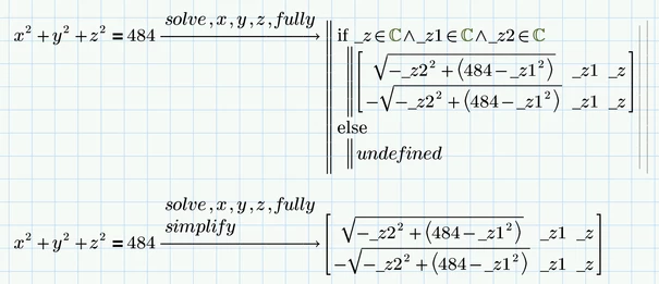

Why Mathcad does not want to show all solutions of an equation?
But also we can see that if:
Why Mathcad (at least Prime 8 ) does not want to show all solutions of an equation?
31 replies

Aug 3, 2023 10:17 AM UTC
The modifier you may be looking for is "fully"
As you can see the new (since Prime 6) symbolics is pretty faulty as _z2 and _z should be the very same!!
The older symbolic (which is still available in Prime 6 ) is a bit better

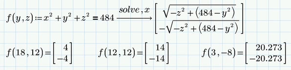

It means that you can freely chose y (=_z1) and z (=_z) and you get two valid solutions for x.
Of course this is the very same you could get with
And don't ask for integer only solutions - Prime will not be able to solve diophantic equations. Using the modifier assume, ALL=integer" or the like will not help!

but you may use
which seems to give you for any value x an infinite number of (usually non-real) solutions for y, depending on the chosen value of _n.
