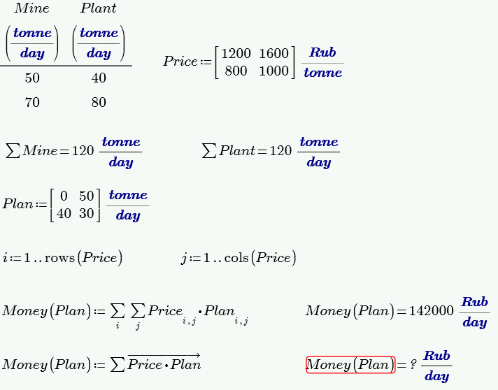

Why??? Sum vector and matrix in prime
I have do so:

Because the summation operator without indices is designed to work only with vectors and ranges, not with matrices.
It's been that way in Mathcad also:
It also doesn't accept pure numbers:
But I would fully agree with you that there is no compelling reason to limit the summation operator in this way. Especially because the mean function accepts all:
One more bad limitation (Net v jizni schact'ia!)
Matrix and vector in Solver!
I'm surprised at you, Valery. Seems to work for me.

Valery, it looks to me that your trick won't work with scalars and nested matrices - right?
