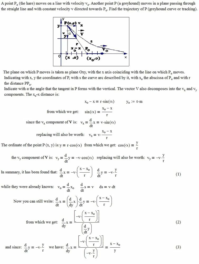

Very beautiful. I also have the analytical solution.
October 1, 2018
Show please!
But the solution without animation is not solution!
October 2, 2018
Hi
I only provide you with the most important part I have developed. Let me know if you find something wrong. (After the formula (11) there is still some simple calculation to do)
Greetings FM.

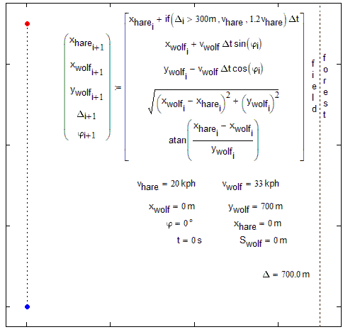

I look and look at this animation and I expect that the hare will still run away from the wolf into the forest...
October 1, 2018
The hare has an afterburner. The hare turns it on when the distance to the wolf becomes less than 300 m. Therefore, the hare can be saved in the forest from the wolf!
Can you solve this problem analytical?
And the second (new, fresh) problem! The hare does not run in a straight line, but along a circular arc!

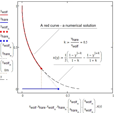

One symbolic solution one partial case of the problem

The DE of the problem. See Pursuit curve
October 9, 2018
Dog -> Wolf -> Hare (see alse Mice problem)
