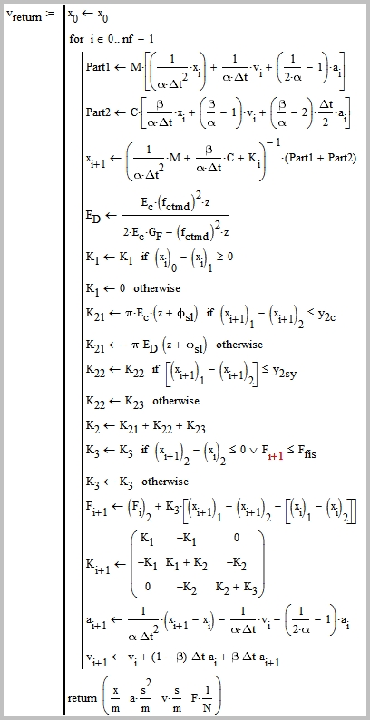

Hi everyone, I'm having lots of issues with one program I'm doing, and I would like to ask if you can help me with one in particular.
I'm trying to pick up a number from a vector compare it with some value and then do an iteration, but for some reason Mathcad doesn't let me pick up the number from the vector.
I'm trying to do:
but it seems that I cannot use this kind of statement in an iteration.

Not sure what the problem is?
v.return is a matrix consisting of four vectors, each containing 21 3*1 vectors.
Where do you try to pic a number from (which?) vector??
BTW, this
doesn't seem to make any sense!?
Another thing I noticed:
As soon as K1 gets 0 the first time it will never change that value again. Is this what should happen? Or did you had in mind that the local K1 should get the value of the variable K1 outside if the program whenever the condition is fulfilled? In the latter case you would have to rename one of the K1, as Mathcad will always take the "nearest" K1 it will find - tha tis the local one if it exist (which is the case after the first assignment).

no you're right, but this it's only because the program isn't finished yet and I have to figure out a couple of things more.

I thought that Mathcad checks each step if the condition is fullfilled and if it is it takes the first definition of K1 because the vaules of x are changing each step.
Despite all of this, the problem I was talking about was with the definition of Fi+1, I want to make a simple calculus with a scalar number, I mean obtain a diferent value of Fi+1 each step but mathcad tells me that it has to be a matrix, and I don't get it.

What do you mean by "first definition"? The one outside of the program? No, it will only take it the very first time the line K1 <--- .... is executed. From then on in the iteration mathcad will take the internal variable K1 anf if this is set to zero in one step, it will stay zero for all succeeding steps. The vector x changes in each step, but why do you think this would affect K1? K1 is not calculated in your routine. It is either set to K1 (which makes sense only the very first time) or set to zero.
But there is no code in your file showing this attempt!? Fi+1 is a 3x1 vector, not a scalar.
