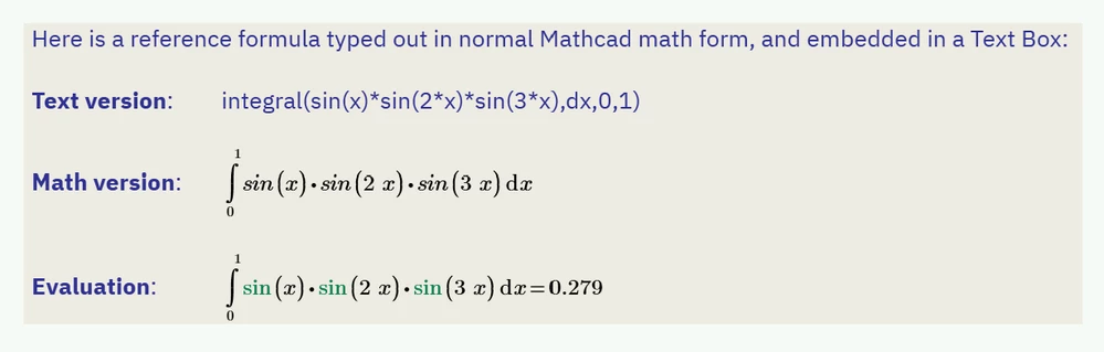

If you just want to create a formula in Mathcad but not evaluate it, just type it in but don't ... well, evaluate it.
Here's an example showcasing Mathcad's ability to embed Math Regions within a Text Region:
AFAIA, if you want to add a formula in a standard C-, Python-, Lisp, Casio-Calculator-like text format, then there is no easy way without you (or, better, somebody else) writing a program to convert the text to Mathcad's underlying functional style and then using the Mathcad API to write the resulting expression to a Math Region.
I have a vague memory of somebody doing this, but the request is a frequent one, harking back to the days of Mathcad Prime's predecessor.
However, it might help if you could give an example of what you mean (even if it's just a scan/photo of a handwritten note).

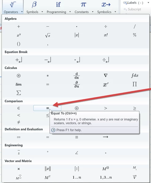

You can just use 'equal to' evaluator (control + =  )which gives the bold equal sign.  It's also used in symbolics but what I use to treat mathcad like a word processor.
Oct 17, 2024 2:02 PM UTC
To (mis)use Mathcad or Prime as an equation editor, you may use the Boolean equal sign = instead of the assignment := or the evaluation =.
Keyboard shortcut may vary depending on the keyboard language.

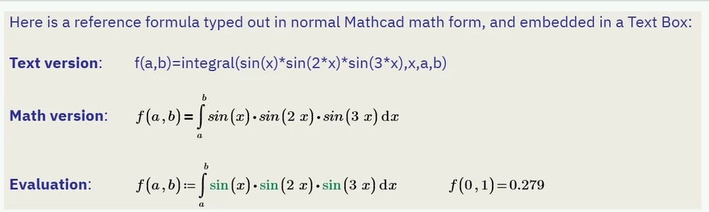

And just to enhance my older answer with something even less new here ...
But it does show the distinction between the two forms quite nicely.
Stuart
Also, looking at the dx in the Text 'integral' of my first answer irritated me but not sufficiently so that I felt like doing anything about it. This gave me an excuse.  Doubtless, something even more annoying will catch my eye within 2 ms of me posting this ...

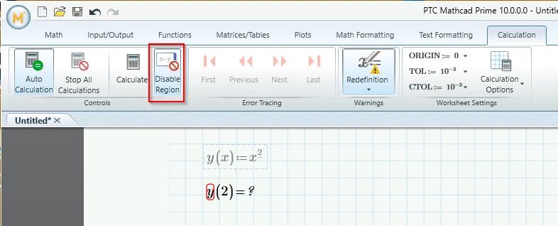

Hello
You can type in the formula as usual. Then keep the cursor in that formula and select <Calculation> <Disable Region>.The formula will be dimmed and is no longer evaluated, so you don't have to worry about overwriting or redefining variables. The formula does print, but also dimmed. I'm not sure if that is acceptable to you.
