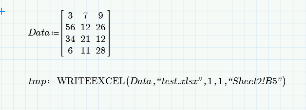

Prime 2.0 has the function WRITEEXCEL. This will write data to an Excel spreadsheet. The function does not have the flexibility of the MathCAD v15. MathCAD v15 will start the writing to a specified sheet and cell. Not having this feature reduces the ability to transfer data to a spreadsheet for pre and post processing. Does anybody have a work around for this issue?

It's such a shame that they never included this, but I can't see a workaround without the use of scriptable objects. I can't understand how they managed to implement the feature in READEXCEL but nor WRITEEXCEL??

The functionality you are looking for is there in Prime 2 as well, only the syntax is changed(I think it is documented on the Migration guide). See screenshot below
Here 3 and 4 arguments represent starting row, col of dataset you want to write. So, 1,1 writes entire dataset.
October 19, 2012
Well done you are correct. I really need to start working on Prime a little more.
My on earth does it say you cannot do this in the help?
