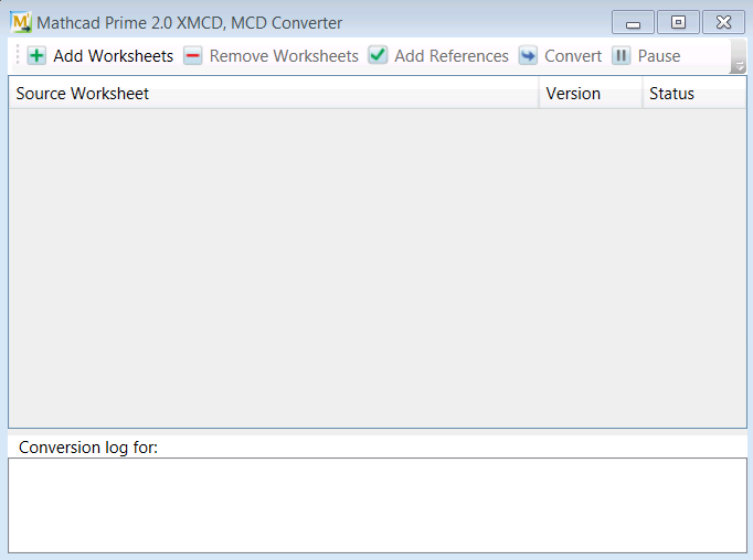

On the ribbon at the top of your Prime window, you need to select the input/output tab, and then click the XMCD, MCD converter.
This will open a pop-up window, open the original file (+add worksheets); then press the convert button.
The process will create a .MCDX file in the same location as the original & also a conversion log listing the items that failed or may have changed.
You will need to check the MDCX file carefully against an original calculation to verify that it is working satisfactorily.
You WILL need Mathcad 15 installed as it uses this to read the original file.
I am still on Prime version 2 but the process will be the same.

Since you said to Stuart it is free version, I assume that you don't have Mathcad 15.
Attached are outputs from conversion.
