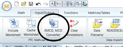

Hello Jack,   Welcome back.   🙂
There is indeed an xmcd to mcdx converter and it should have come with the Prime package.   You can access it via the Input/Output ribbon
You will also need to download Mathcad 15 (if it didn't come with your installation).  This is downloadable from Download PTC Mathcad 15.0 Free | PTC with a 30-day trial licence, after which you should be able to couple it to your Prime licence (unless that's the trial licence as well!).

> If I can get the translation to work (no reason to think it won't)
Thats far too optimistic. If you knew Prime you would have a lot of reasons to think it won't.
You sure will get the translation to work but its questionable if you are happy with the converted files.
Stuart has already mentioned it - Prime is missing a lot of standard features of Mathcad 15 and below. So it depends on the content of your sheets if the converter will be able to create a fully working Prime sheet. Sometime just pictures of the Mathcad 15 (or 14) content are inserted because Prime does not support the feature - so watch out..
If your sheets are using just basic feature, chances are that conversion will be successful.
