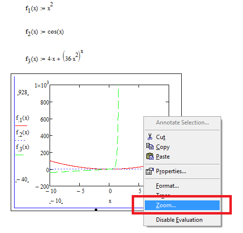

Dear members,
I have trace many curves in one plot. now I want to zoom a specify area of this plot. could someone can tell me how I can doo it with mathcad?
I have attached the file.
Thank you
November 15, 2012
Right-click on the plot and select"Zoom":
November 15, 2012
The fact is that the zone where I should put parameters for zooming is not activated.
November 15, 2012
It seems to work by selecting the area to zoom using the mouse.
click & hold the left mouse button & drag to define the area.
