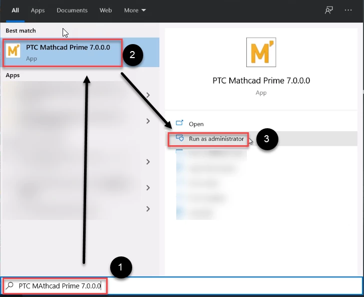

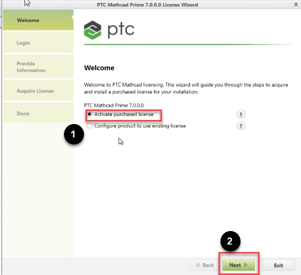

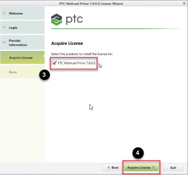

1. Run LicenseWizard.exe from default location C:\Program Files\PTC\Mathcad Prime X.0.0.0  ( Mathcad Prime 7.0.0.0  - 8.0.0.0 ) or Launch using Windows #Search and #Run as administrator

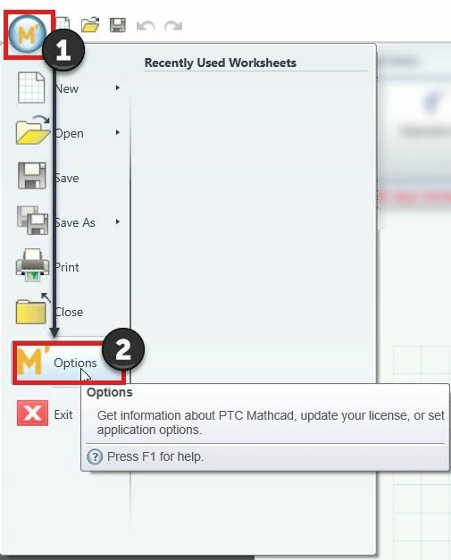

2.  Select Mathcad Icon M' and then select #M' Options

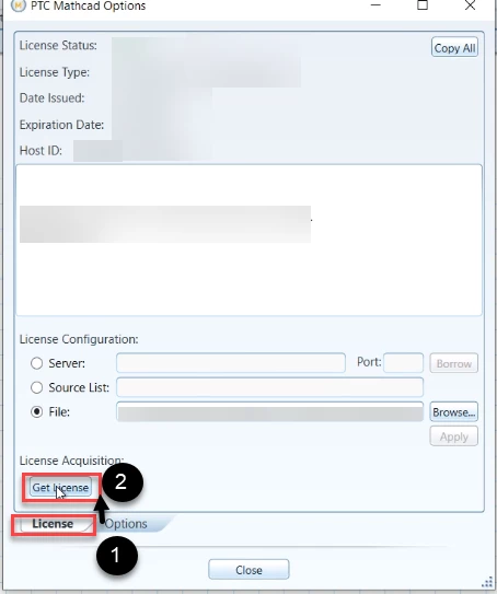

Select option #License

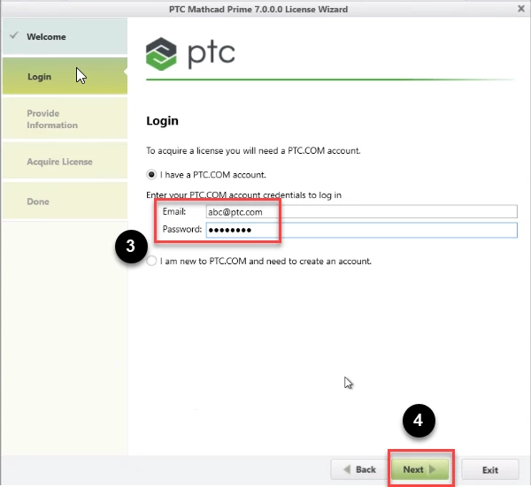

3.  Follow the Steps as highlighted in numerically ascending order and select #Next

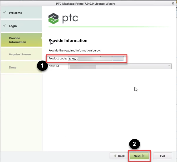

4. Enter the Product Code, #Next on Acquire License Page check the product for which the license needs to be activated  and select #Acquire License (4)
 5. After selecting #Acquire license, a license will be generated for the provided product code. User can double click on the Mathcad Prime icon and launch the application successfully.
7. Now you are all set - You'll be able to launch Mathcad Succesfully!!!!
