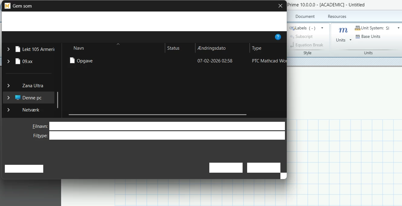

I recently purchased a laptop running Windows 11 Home. I installed Mathcad Prime 10.0.0.0 using a university license provided by my university in Denmark.
The problem occurs every time I try to save or export a file — the application crashes immediately. This happens consistently and makes the software unusable for my studies.

February 7, 2026
In the image see the following is not done:
Choose a folder not just Penne pc
The Filtype is not chosen use PTC Mathcad Worksheet (*.mcdx).
If that does not work try Save As
