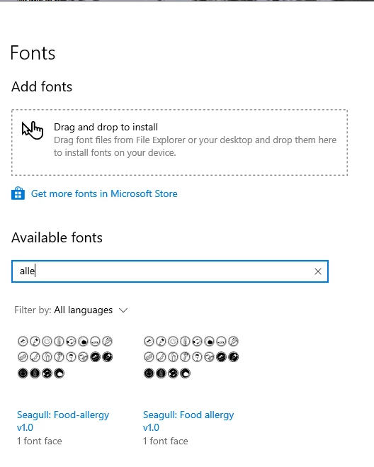

Recently I have been having an issue where MathCAD Prime will nto run on my PC anymore. It loads the splash screen and then nothing happens afterwards. Looking at the task manager, a PTC MathCAD process begins but disappears when the splash screen disappears.
I have followed the steps in the other relevant forum posts (below) and contacted PTC technical support for help with this issue but the only fix was to completely reinstall windows. Uninstall/Reinstall does not help, nor does copying config files from a PC where the software is still working. Compatibility mode does not help either.
https://community.ptc.com/t5/Mathcad-Installation/Prime-4-0-does-not-run-anymore/m-p/803946
https://community.ptc.com/t5/Mathcad-Installation/Mathcad-Prime-does-not-launch-after-the-initial-splash-on/m-p/729884
Now, 2 months later the same issue is happening again. There are no other issues with my computer, everything else runs fine except MathCAD Prime. It does not matter whether it is Prime 8 or 7.
I was running Windows 10, but since the issue cropped up again I updated to Windows 11 and the issue persists.
I should not have to reinstall Windows to fix this issue. Has anyone else found a fix for this issue or a way to identify which windows update is causing the problem?

I finally got a solution!!
It turns out that a different software that I had installed came with a font pack that contained 2 fonts with nearly identical names. MathCAD must parse the windows fonts folder during startup and was returning an error because the names were so similar.
As soon as I deleted one of the fonts, MathCAD Prime launched without issue.

Mar 6, 2023 2:14 AM UTC
