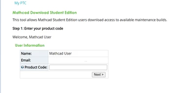

I am a student who uses PTC Mathcad Prime 11.0 for my coursework; however, starting today, the program will no longer open/run. I have tried restarting, uninstalling, and all the basic troubleshooting. After hours, I am at a loss, and this is the only way I could find to contact any sort of customer support at this time. Everything else implies some invalid product codes or says I need a support plan. I have purchased Mathcad Prime and have been using it normally for almost a month, so I am wondering what all this is about. If you need any specific info, please let me know.

Or get latest from: ( There has been a new issue this month)  go to https://support.ptc.com/appserver/lm/mathcad/download/index.jsp?as=1
