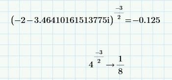

mathcad cannot handle correctly the swap of negative symbol in odd powers.
Specific, calculating this expression (-1/8)^(-2/3) gives an imaginary result instead of the 4 as result
    8 replies

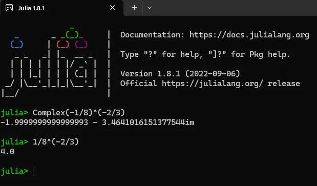

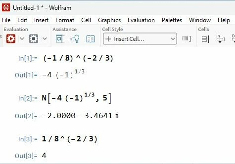

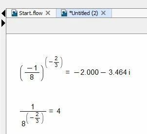

    terryhendicott

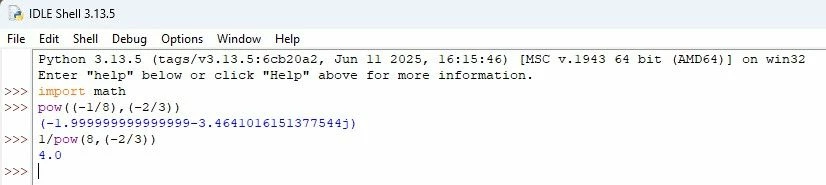

    Mar 16, 2026 11:26 AM UTC
    Prime gets this:
    Maple Flow gets this:
    Matlab gets this:
    Julia:
    Cheers
    Terry

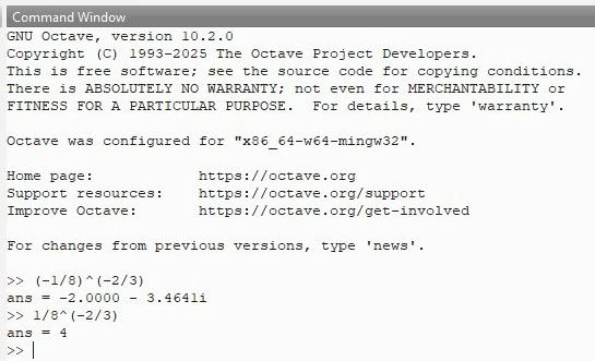

    terryhendicott
    Mar 16, 2026 12:14 PM UTC
    Octave:
    Wolfram:
    Python:

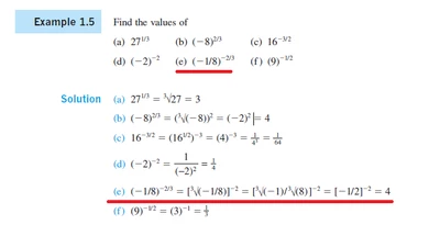

    Mar 16, 2026 3:29 PM UTC
    The original solution as presented in the book MODERN ENGINEERING MATHEMATICS
    Glyn James, Phil **bleep**, Sixth Edition
    page 7
    is as shown in screenshot. Its just a simple and direct solution on this.

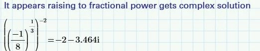

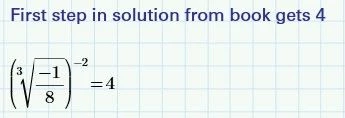

    terryhendicott
    Mar 16, 2026 6:26 PM UTC
    Both answers are correct:

    Mar 17, 2026 7:22 AM UTC
    Thanks for spotting this, remember 7 mathematical programs get the complex result.
    You can with some manipulation of the problem get 4.
    The first step in the solution from the book gets 4.
    It seems cube root gets 4 raising to the 1/3 power gets the complex result.
    Very interesting learning thank you for spotting this.
