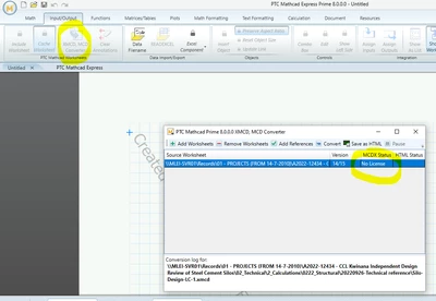

Hi all, I have a Mathcad file created by Mathcad2015 (my best guess). Now that I'm using mathcad prime 8 (trial version), I can't open the old file. When I use the XMCD,MCD Converter button in Input/Output and link the path to the file and press "convert", the "MCDX status" says "no license" and I can't convert to open it in prime 8. Could you please help me with this. I can send you the file for your reference.

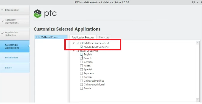

1. Starting from the 7th version of Mathcad Prime you can use the built-in converter (before the installation process, it is necessary to select it among the installation components).

I actually ticked that and was able to open the converter in the prime8. Just that when I press "convert" it says "no license" as I described in the original question (also as shown below). Please see attached the files that I want to convert. Many thanks for your help converting them for me.

You've got Prime 8 Express installed, but not applied for (and received) a license. This license is required to use the full feature set of Prime (for a period of 30 days max.)
Read here how to apply for such license: https://community.ptc.com/t5/Mathcad-Installation/How-to-Acquire-30-days-License-for-Mathcad-Prime-7-0/m-p/721613#M413
After the license expires Prime falls back to Express mode, which means: No Symbolics, programming, solve-blocks, conversion, and advanced functions such as mean and stdev...
