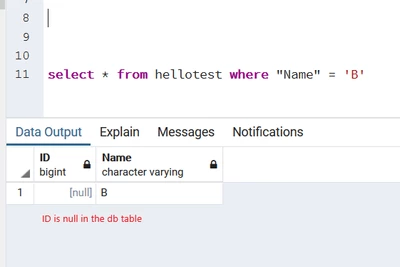

Hi @eribbeck ,
Please try passing the column as blank (empty), in the database it will become null.
I tried at my end, below are the screenshots.

@hchanana I should have also specified that the field I'm trying to update to null has a foreign key constraint, as that still doesn't work for me and this field. If I leave a field blank in the update it doesn't update the field.

Hi @eribbeck ,
If you are updating a column to null which is a foreign key, then it must be linked to primary key of some other table. And primary key can never be null. Due to which application is not allowing you to update the value to null.
Even if you use database query editor, it will now allow you to update the column with foreign key constraint to null.
Hope the explanation clear to you.
