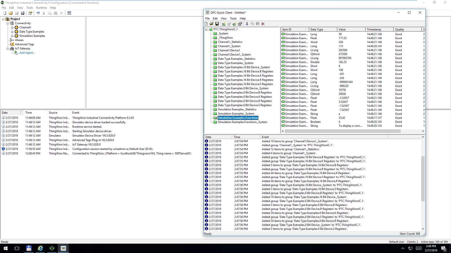

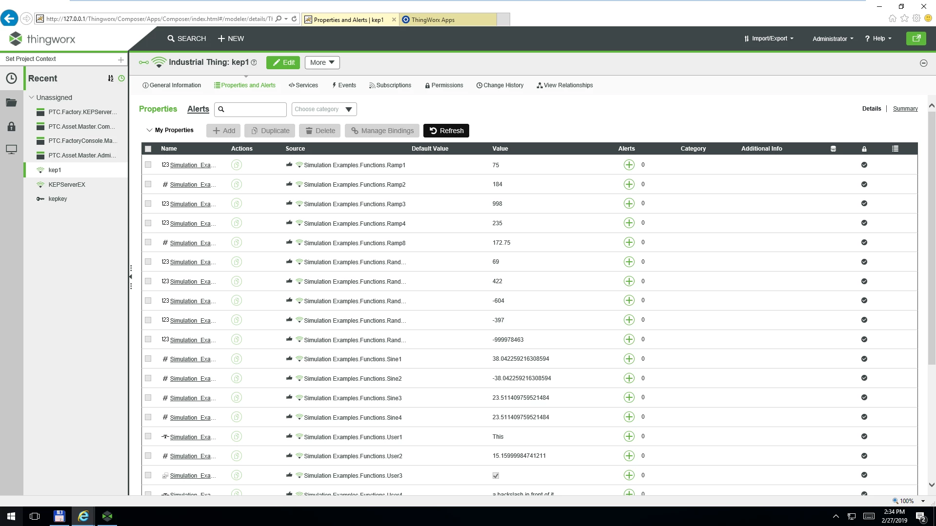

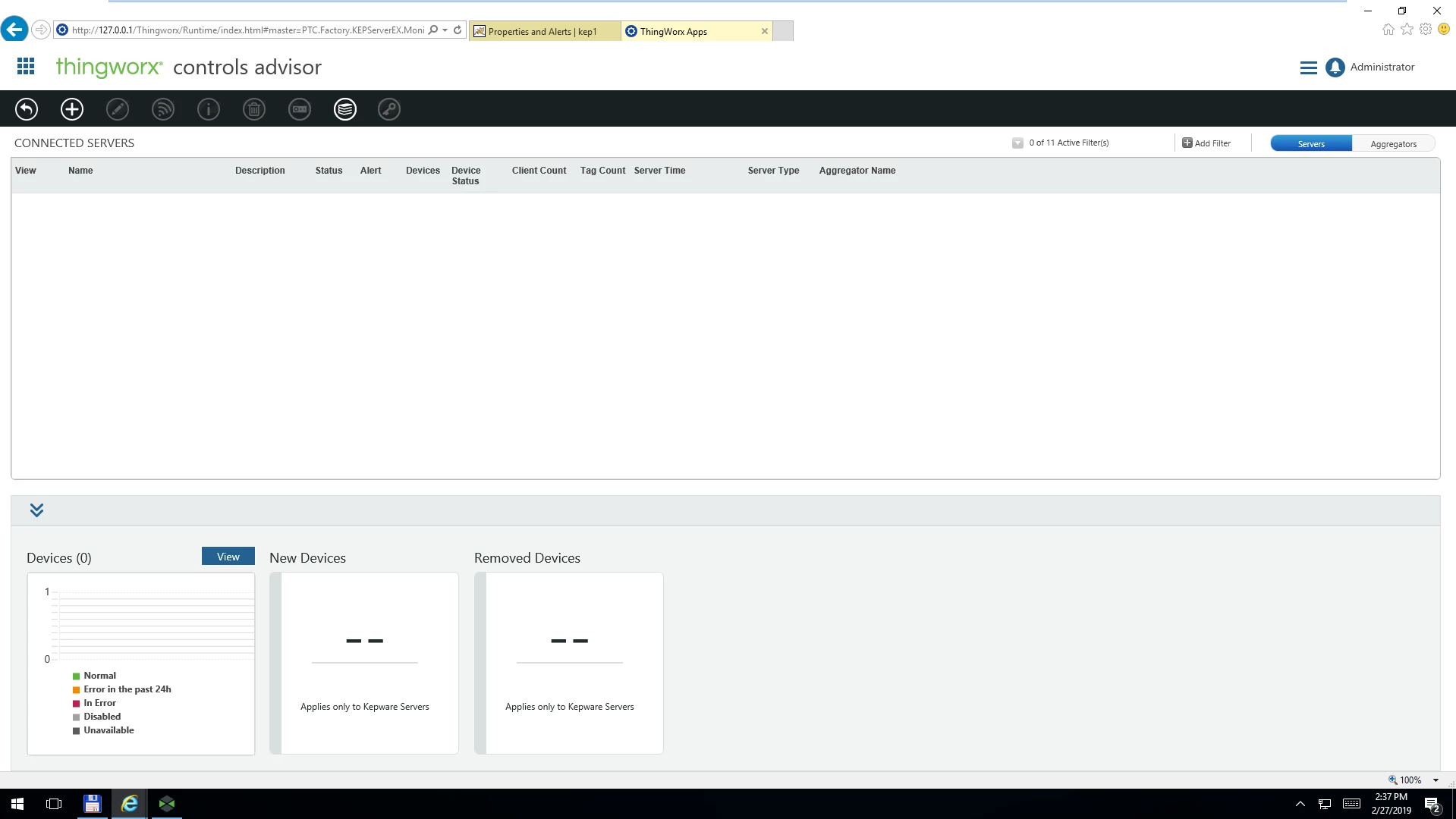

domrachev1-VisitorAuthor
February 27, 2019
I reinstalled the operating system and all applications, and I also had to update the license. Now it looks like this:
Windows 10x64 Enterprise 2016 LTSB
Tomcat 8.5.23
Postgres 9.4.21-1
ThingWorx 8.3.3-b937
Manuf Apps 8.3.1 Extension
Industrial Connectivity 8.3.65 ( V6.5.828.0)
In the Composer, I see all the tags, in the old and new versions. In the Advisor can not see the server.
I attach screenshots to the message text.
Thank you, Peter.
February 27, 2019
Peter,
Controls Advisor is adding tags and ThingShapes to the object and is just showing server that has this specific configuration in the UI. Could you please send a screenshot of the Industrial Thing general page of the object that you have create from Controls Advisor. Controls Advisor also creates a proxy thing with the name of the Kepware server as normal thing that will holed all tags, could you see if this object gets created.
Seb
