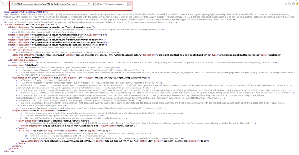

now I using thingworx manufacturing apps 8.4. I want to set SSL certificate. when I configure SSL configuration following https://www.ptc.com/en/support/article?n=CS193947 part B code cannot find, which is
<Connector port="8443" protocol="HTTP/1.1" SSLEnabled="true"
maxThreads="150" scheme="https" secure="true"
clientAuth="false" sslProtocol="TLS" />
below is my default server.xml content.
WeChat Screenshot_20191101092310.png and also have my file location.
Could someone help me to figure it out?

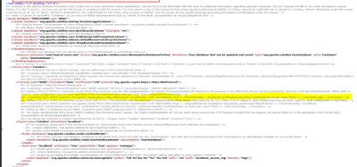

Hi @xiaoqw ,
The similar settings are present in your server.xml (only protocol type is different)
Highlighted in below screenshot.
You need to uncomment the highlighted line and make the changes as recommended and update the path of your keystore file as per your system.
Comm
Himanshu

Hi @xiaoqw ,
Yes, both certificateKeystoreFile and keystorerFile are same.
Just add the following code on your server.xml and update the path of .jks file in keystoreFile and password in keystorePass.
Spoiler
<Connector port="8443" protocol="org.apache.coyote.http11.Http11NioProtocol" SSLEnabled="true"
maxThreads="150" scheme="https" secure="true" clientAuth="false" sslProtocol="TLS"
enableLookups="false" keystoreFile="conf/tomcat1.jks" keystorePass="changeit" />
The other query regarding joining second domain is not clear to me. Please explain in detail about what you are trying to achieve using two domains.
In this case there is one tomcat server and keystore is generated for this only and we are using it for authorization.
