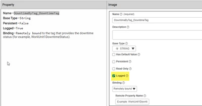

The RTPPM models are processing data from the value_stream. Ensure that the model properties are set Logged-True as referred in the PTC Help Center.
Binding - Remotely is the standard method for receiving data through the Kepware ThingWorx Connector. It is possible to keep the Binding-None or Local depending on the data source.

- Downtime : DowntimeByTag_DowntimeTag (and optionally DowntimeByTag_DowntimeTagHistory)
